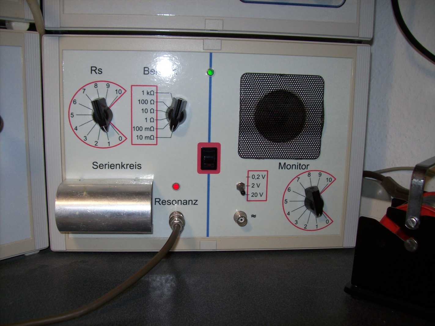

Hi Gerard,

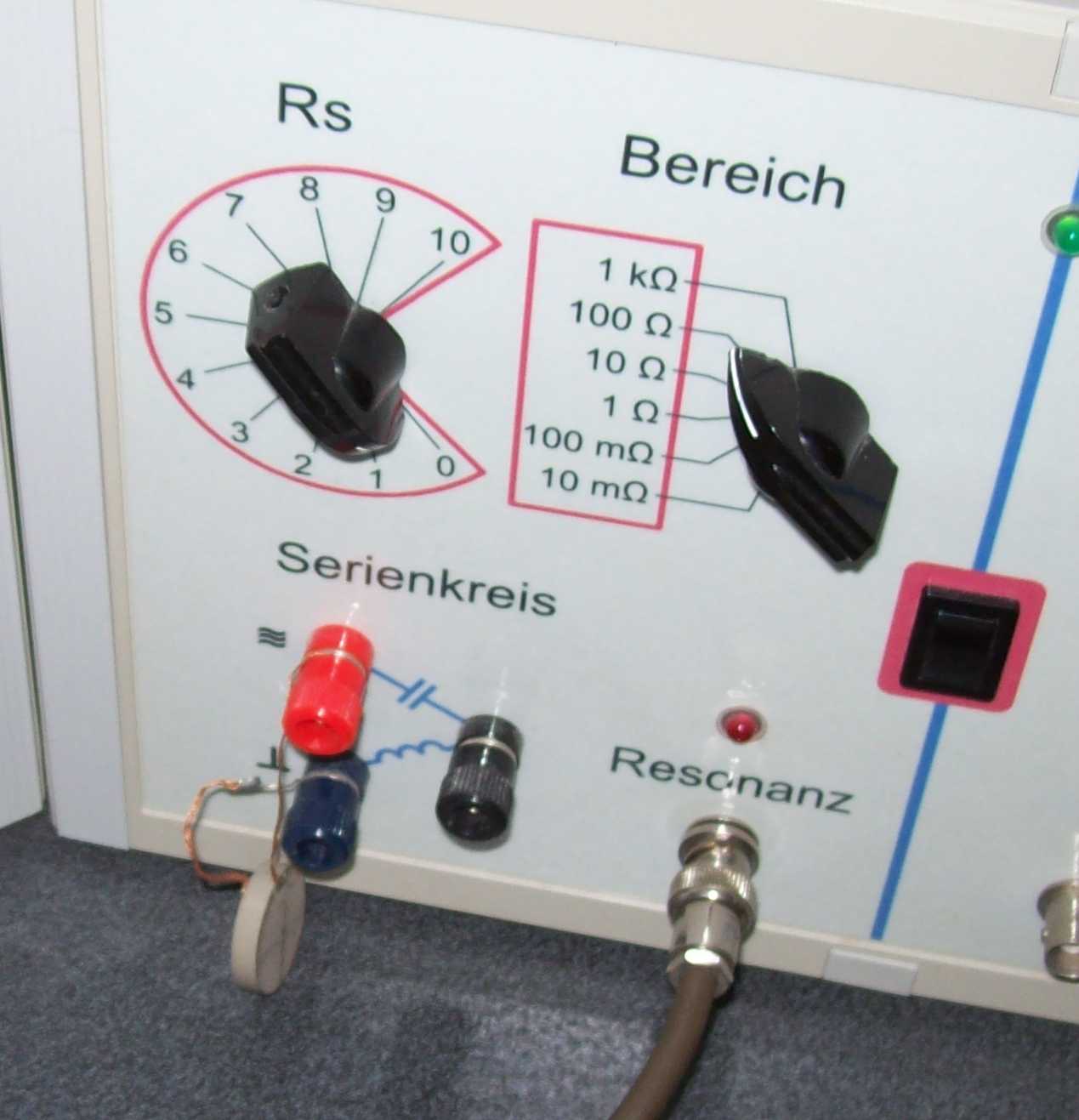

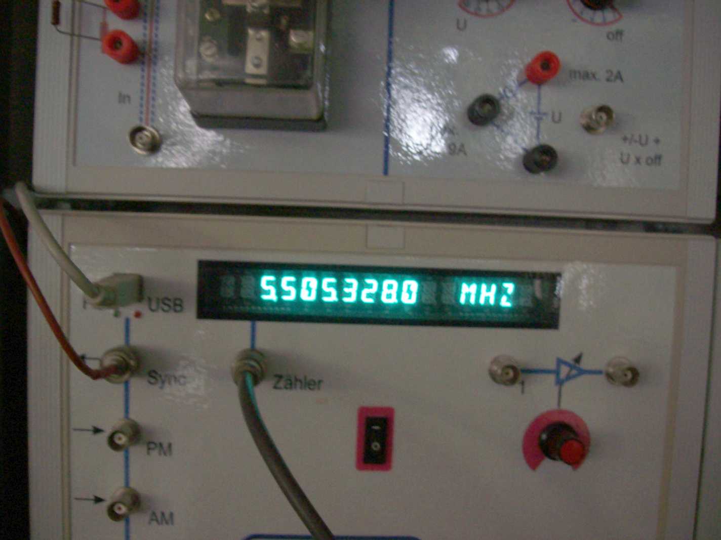

I simply connected the piezo ceramic to a measuring device:

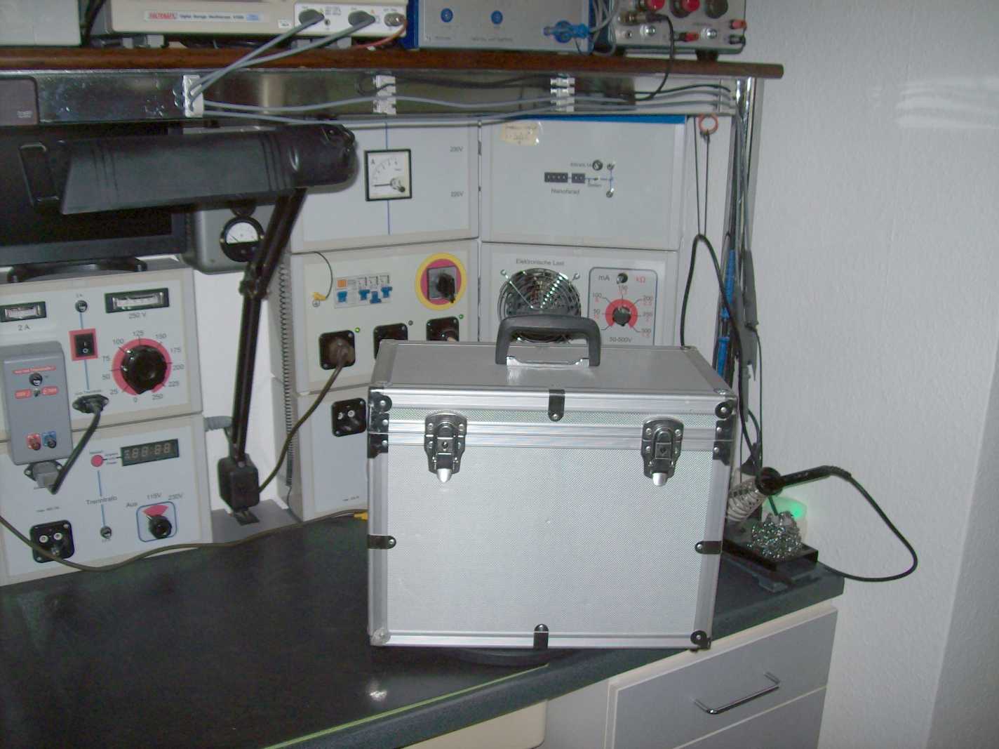

and placed my heavy vacuum pump in the case on a turntable in front of it:

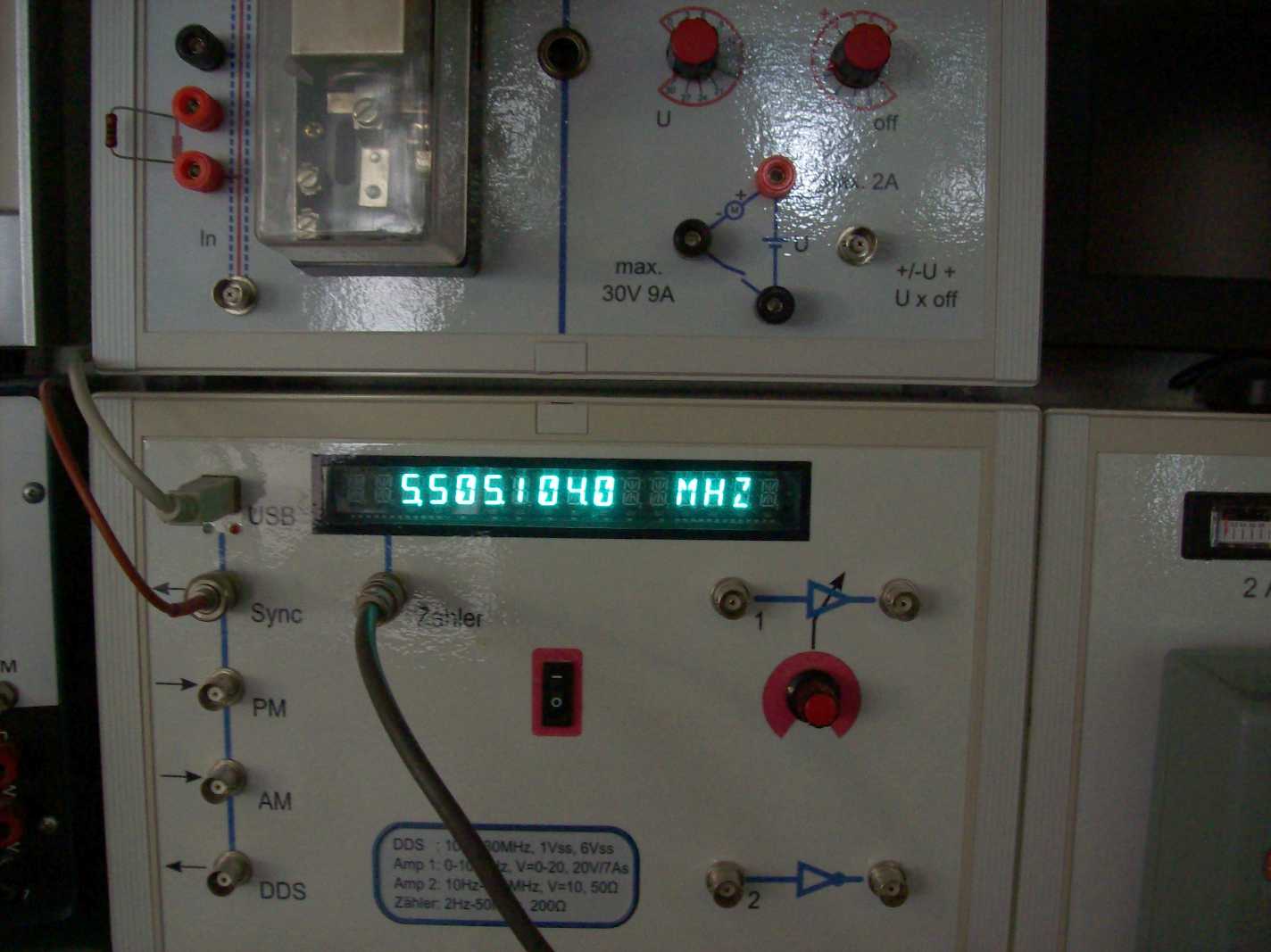

The following frequency is measured:

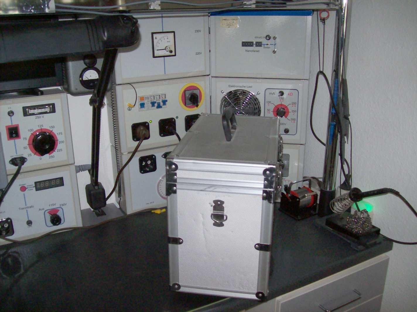

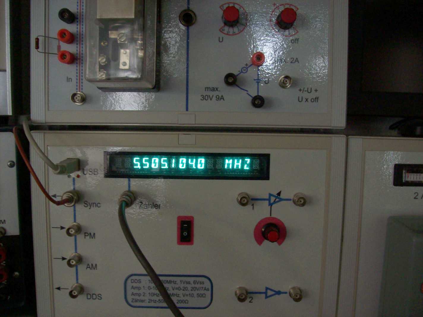

The case is then rotated by 90°:
And the frequency changes significantly:
Of course, this still needs to be checked for faults. It is conceivable that the piezo reacts to the changed stray capacitance.
The piezo may have to be placed in a shielded housing. And then series of measurements must be made.
But in principle, that's actually the way I have in mind. So - if everything works out - I can finally tell you the oscillation frequencies of the piezo as a function of the angle of rotation of a heavy mass.
Would that be enough for you?
Best regards
Wolfgang

So you checked the tuning by stray capacitance now - fine !
Better:
Just use a standard crystal, maybe 1 MHz, in a metal can HC-18 (-> grounded !) , then try again.  misstrau
[Bild: shopping?q=tbn:ANd9GcTBrj4CswW-XdUdYYjGh...4PRSq79qVH]
-- and screen connecting wires also !!!
ANY changing stray capacitance will change frequency - thats the standard way, to tune crystal oscillators.

I admire your enthousiasm. I know (almost) nothing about electronic devices. Do I understand correctly that the vacuum pump in the case on a turn table is the source of the frequency? I am afraid that its waight is much to little. Maybe a iron cylinder of several nundreds of kilo's is needed. And a heavy lead block attached to the piezo crystal. I wonder very much how sensitive piezo's are. Can they perceive forces as small as a micro gram (or even smaller)? I am very curious to your results.

I realize that you had much heavier weights in mind. But then I would have to sit on the turntable myself.... Wink
The basic idea is to measure the curvature of space directly. In other words, that the piezo oscillation frequency changes depending on the gravity acting on it.

No deterioration or improvement with a screen.

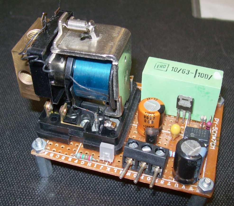

Today I'm going to take a closer look at the various resonances of my piezo.
Parallel I made an electromechanical representation of Gerard's pendulum. A microcontroller measures the closing time of a relay connected to a seismic mass with a linear increase in relay current. The supply is 24V and the output is PWM.
The sensor works without any problems and is interference-free. However, I don't yet know whether the sensitivity is sufficient. Maybe I really need to lie in front of it lengthwise and crosswise to carry out the experiment.
